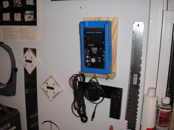

Well,I have the older model VS-1 John. The screen is a little jumpy,but I can still get it to work well.They say the screen on the newer models are much better.These strobe
tuners are very accurate.I have mine mounted on the wall which makes it handy .I can't give you any technical info on them but I do like them much better than your basic tuners.
